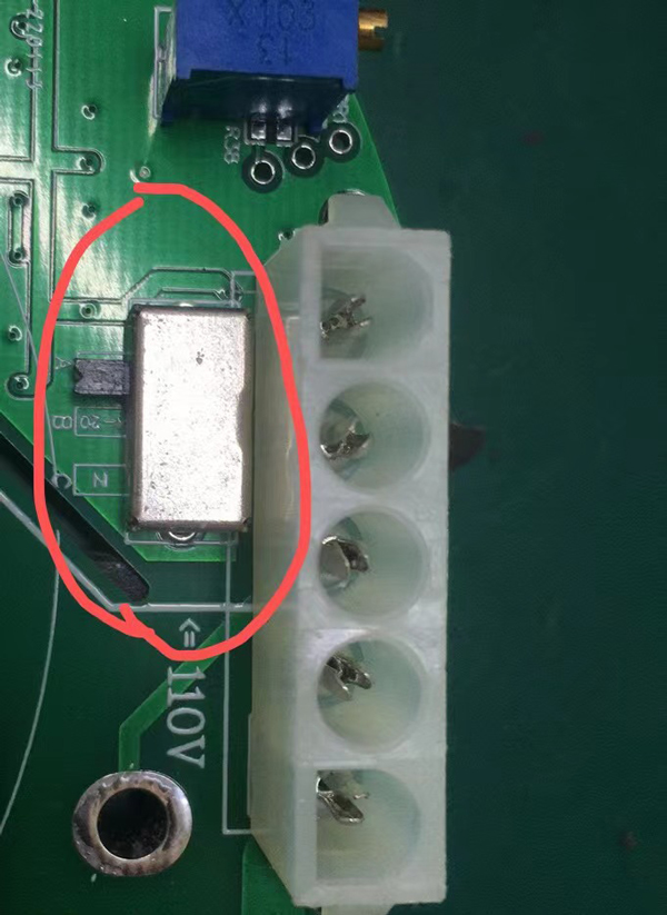

    If the blower still fails to start normally, please provide us with the position of the DIP switch as shown in the attachment, so we can check whether the DIP switch is set correctly. Please see attached.

    Hi,
    The dip switch is in position A, same as in your photo.

    Hi Beckett,
    Pls set the dip switch to position C and test again.

    Ah! It works now.
    Thank you!
