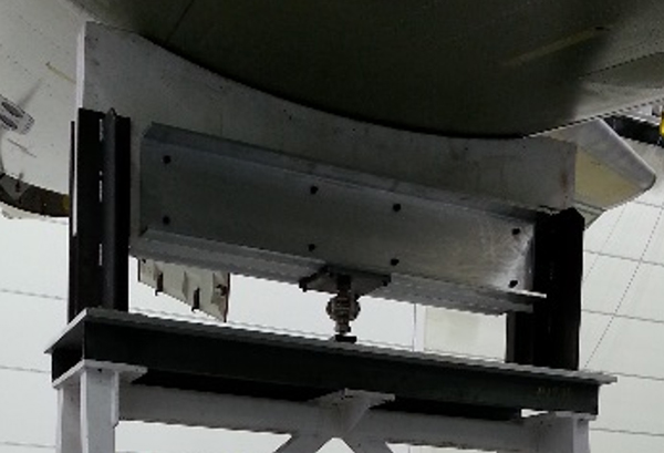

We have a requirement to build a tool that measures the force in LBS applied to certain parts of our airplane in different configurations. The weight to be applied could go up to 12000 lbs. We have multiple measuring points, (starting with 3). We would need to read all from a single position (multiple display/reading). In some cases connect two load cells to one weight value (junction box).
Do you also have a controller to connect multiple load cells with an output to a Windows computer software instead of a digital display?
We are currently looking for (5x) ATO-LC-TC03 (10 ton) or ATO-LC-P01 (10 ton).
For example, in the configuration below we would need to have 1 and sometimes 2 load cells.
2

We can only provide multiple weighing sensors connected to a junction box, the junction box output signal is connected to the digital display of the load control instrument, and then the 485 signal output by the control instrument is connected to the Windows computer software to display the value of the load cell, including displaying the real-time data curve and history curve. Each load cell can be connected individually to the controller and displayed individually, or six load cells can be connected to the junction box and then to the load control to display values together.
Are you able to provide a bill of material and a quote for a complete kit?
1. (6x) load cells at 20000 lbs. each
2. Junction box
3. Load control instrument with display (able to read each weight)
10 months ago
