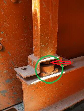

    See the attached photo of our installation.
    This load cell ATO-LC-TC03 can be made of stainless steel housing with an IP67 protection level, and the current minimum range is 0-300kg.
    We recommend Option 3:
    4 compression load cells on each corner per box, is a better solution.
    Put a bottom plate under the box, like a platform scale, so that the box will be more stable.

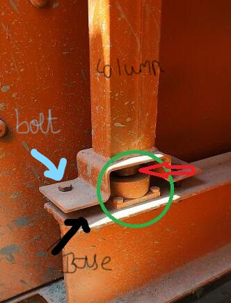

    Question 1:
    Also, from the image you forwarded, can you tell me how these bolts help? (See marked). From my understanding, if the column is bolted to the bottom flange, won't the cell already be compressed based on the torque of the bolt?

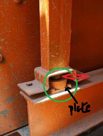

    Question 2:
    Also what is holding the load cell in its place? I see a small plate with 4 bolts underneath the cell, above the bottom flange. Is the load cell just placed on top of the plate or is it bolted somehow?

    1. The two bolts on the bracket are not fully tightened. There is still a certain distance between the screws and the steel plate at the bottom. It is only used for limiting.
    2. There are 4 screws on the sensor base, which are used to fix the sensor and prevent the sensor from moving.
