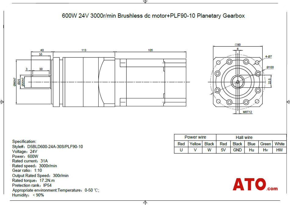

    Hi Bohen,
    We recommend a 600W 24V DC 3000rpm brushless motor equipped with a planetary reducer with a speed ratio of 10:1, with a final output of 300rpm, 17 N.m.
    Please see the following motor drawing to check whether it meets your requirements.

    If you're replacing a pneumatic gun, just make sure you're not underestimating the torque spikes. 15Nm minimum is fine on paper, but real-world loads can jump a bit. 17Nm gives you some margin, though.

    Bohen, 600W at 24V is going to pull some decent current. Make sure your DC supply is sized properly. Also, double-check whether that 17Nm is continuous torque after the gearbox, not just peak.

    Got it, thanks everyone. We'll review the 600W 24VDC BLDC motor with 10:1 planetary gearbox (300rpm, 17 N.m output) and check the drawing in detail. We'll also confirm the continuous torque rating and make sure our 24V supply can handle the current before moving ahead with the demo unit.
