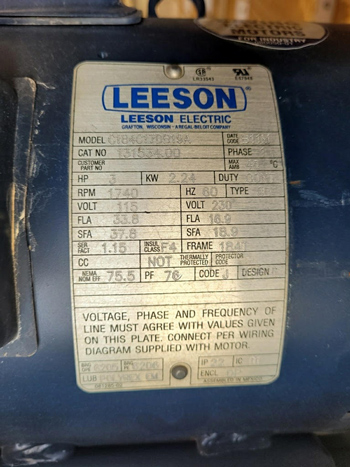

    I set all the parameters as per the sheet and also set group PA. The motor starts and runs, but it has a bad vibration, and the amperage is higher than the nameplate, which causes the overcurrent device to trip.

    Your motor nameplate shows that the motor is dual voltage 115V/230V. You should connect according to 230V voltage, and find the motor's user manual to confirm whether your wiring has been connected according to the 230V connection method, for the current 33.8A corresponding to the 115V voltage is greater than 23A of the VFD output current capacity. Please check whether your motor wiring is correct.

    It's wired for 230 volts. It runs fine with a motor starter. I've installed over 100 VFDs in various environments, but this is my first time with a single-phase motor. It's not going well. Can this VFD run a three-phase motor with a single-phase input? If so, I'll just replace the motor.
