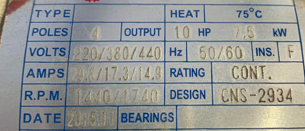

    Thanks. We tried that. The VFD still trips on E-03 after about 4 cycles of the motor. I've attached a photo of the motor nameplate for reference.

    Thanks. We reviewed the motor nameplate — it supports 220/380/440V. Your VFD outputs 220V 3-phase, so please confirm the motor is wired for low-voltage 220V operation.
    Additionally:
    1. Disconnect the motor and inspect for shorts or damage.
    2. Try running the VFD unloaded (no motor attached) to see if it still throws E-03.
    3. With a multimeter, check for 220V between U-V, V-W, and W-U during operation.
    4. If it runs fine without load, your motor may be miswired or faulty.
    Additionally:
