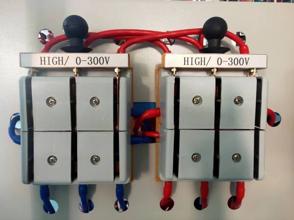

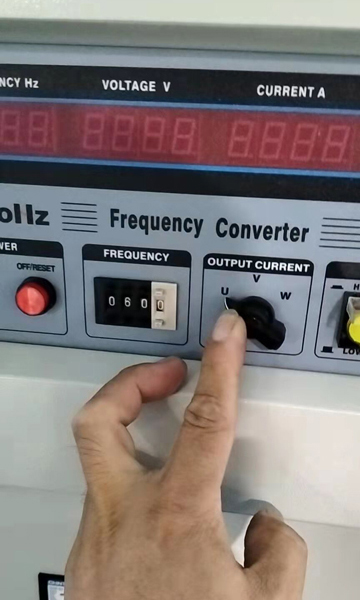

    Specific operation method: When using single-phase (such as single-phase 230V), the wiring is to connect U-N, or V-N, or W-N (recommended to use V-N), and then set the knife switch to the high level (the knife switch needs to be pushed up to correspond to Phase voltage 0-300V), selecting the switch on the panel to V phase (as shown in the picture), then adjust the ADJ potentiometer to adjust the voltage to 230V, and finally set the frequency to 60Hz.
