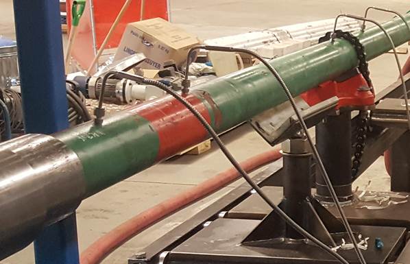

    Previously used: A sensor as shown in the attached image (threaded into the metal tube)

    Thanks for the response. Here’s more clarification:
    1. The tube is made of metal, and the threading is fine. That’s how we’ve installed thermocouples previously (see image).

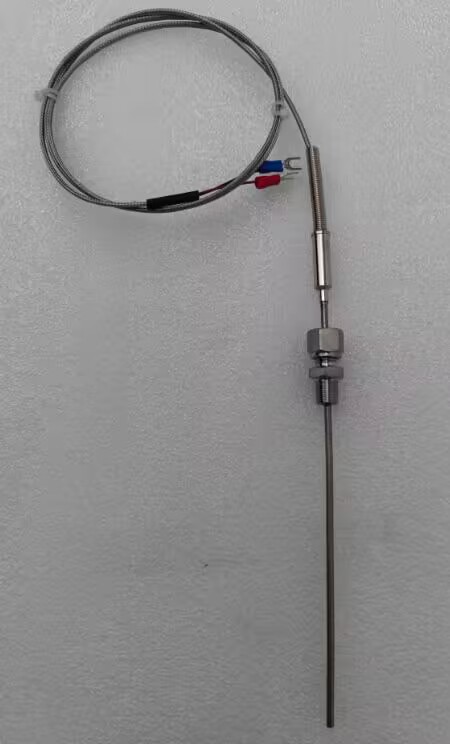

    Isolde, based on your details, we recommend:
    Model: J-type thermocouple ATO-TC-JS
    Probe diameter: 5mm
    Insertion depth: ~20mm
    Connection: 1/2NPT threaded
    Lead wire: 6m with heat shrink at junctions
    Temp range: 20–150°C
