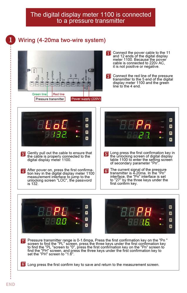

    Hello everyone, I am trying to use both an ATO digital panel meter and a pressure sensor to measure pressure. The SKUs are: ATO-PRES-P300G and ATO-DPM-USD4D. The digital display meter is only reading -25 Celsius on startup. I am trying to get to the settings to change the reading to a pressure reading, but some of the settings indicated in the manual are not appearing on the PV display window. For example, I am trying to get to the "Print unit" display, but the meter goes directly from "Filter coefficients" to the "Displaying input zero shift" setting. Could you possibly help?

    Hi Beckett,
    0-100kPa pressure transmitter, connect to the digital display. Please refer to the attached picture for the steps.
    11 months ago
    Hi Beckett,
    Thank you for your prompt reply. However, I do see that the display is still showing Celsius in the SV panel. I followed the steps in the images and connected the pressure sensor correctly. Any ideas on how I can fix this?
    Does the pressure sensor need to be powered? It says 24V on the pressure sensor body.
    11 months ago
    SV displays degrees Celsius.
    This temperature display can be turned off by setting SdiS=7.
    Yes, the pressure sensor requires a 24V DC power supply to power it.
