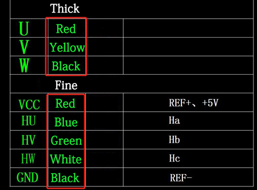

    Please connect the wires according to the wiring diagram we provide. The wire must be connected, and the controller will flash and alarm if the wire is removed. We guess that the cause of the problem is that you connected the extension cord, and the improper wiring caused the alarm. Try removing the extension cord and rewiring it according to the following wiring diagram.
