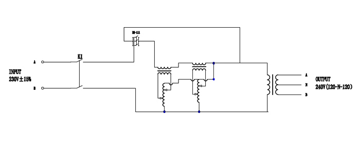

    Yes, the stabilizer supports input voltage variation between 240V AC and 260V AC while maintaining the output at 240/120V (L1, L2 + N, G) ±3%.
    Please find the following data and attached schematic diagram for further details.
    Single-Phase Automatic Voltage Stabilizer, 75kVA Capacity
    Input Voltage: 230VAC ±15% (L, N, G)
    Output Voltage: Split phase, 240/120V (L1, L2 + N,G) +/-3%
