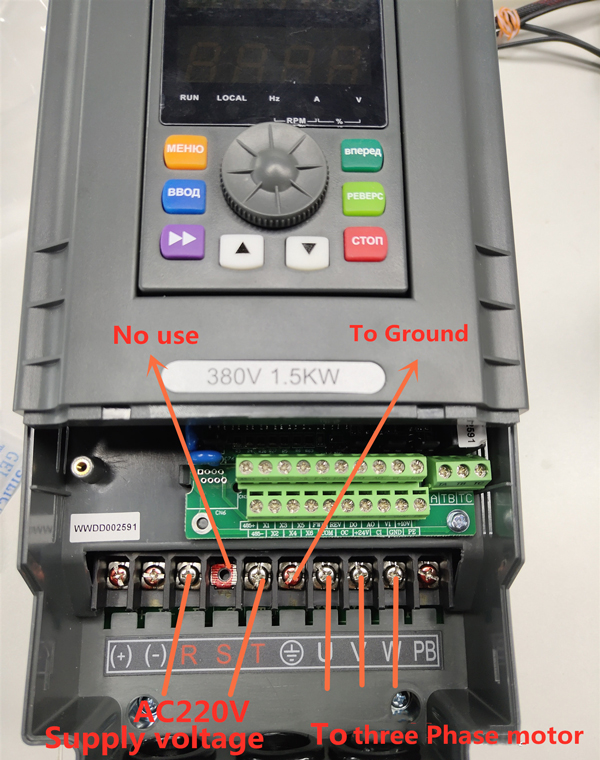

    This Neutral Wire cannot be connected to the VFD, but can be connected to the ground. Please refer to the attached picture.
    Note that the 15kw 220VAC single phase to 380VAC three phase VFD you purchased can only be used to connect three-phase 380V motors, and cannot be used to provide power to your equipment, otherwise the VFD will fail.

    This is because VFDs are usually only used for motor load. If you use it as a power source to supply power to machines and equipment, it may be unstable and cause malfunctions.
    For your application, we recommend using a Single Phase to 3 Phase Converter, which can convert your single phase 220V to 380V. Please see the converter spec on: https://www.ato.com/phase-converter
    Please also let us know the total power, voltage, maximum starting current and other data like these of the laser cleaning machine you are using, so we can recommend an appropriate model.
    Of course, you can also use this VFD for testing now, but we do not guarantee that the VFD will run your machine properly. Anyway, you can try testing first.
