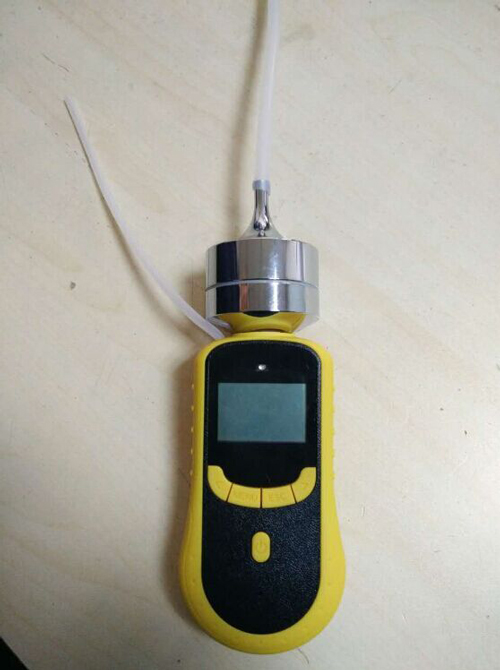

    Based on your requirements:
    We recommend using the GD200-NH3 Ammonia detector with a 0-10 ppm range.
    For airtight connections, we will supply two gas tubes to ensure proper sealing. One for the gas inlet and one for the gas outlet.
    The handheld gas detector supports data logging, which will meet your need for continuous monitoring over several hours.
